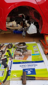

I've done two LSD retrofits on our Stingers with open diffs. Job is pretty straightforward but awfully tedious. Biggest PITN is removing the half shafts. Depending on how long yours has been in the car, the half shafts splines might be stuck in the wheel hub good. Our '19 too some serious persuasion with a sledge hammer, while the '23 came loose much easier. You could also try it with a (bearing) puller. After that, pulling them out of the diff just takes a healthy yank. I don't mean an American with good physique. The half shafts are retained in the diff with a spring circlip. You're gonna pull HARD, so make sure your elevated rear end is well supported. I myself prefer two heavy duty floor jacks, instead of small jack stands.
After that, a third floor jack helps with R&R of the diff. While it isn't all that heavy, and you probably could try to support it manually, working with a floor jack makes it far easier to manage, especially when raising it up into position for re-installing.
You might be able to do it without fully removing the knuckle. I had to do that the first time (red) because I was also replacing the rear brake dust shield after a Brembo retrofit. I found having it out of the way made pulling the 1/2 shafts easier, so on the second (white) one I also dropped the knuckle.

Hi,
thanks for the detailed information and the pictures, appreciatte it.
I had to replace one axle a few months ago and yeah it was hard to get out until i bought the correct tool, probably slide out this time. I'll give it a go over the next few days, see how i go.
Again thanks a lot for your reply
