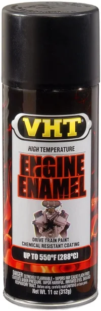

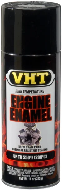

Enamel HT Paint:
(SATIN/FLAT/GLOSS IN THAT ORDER - SEE CAP FOR REFERENCE)
You can buy these HERE

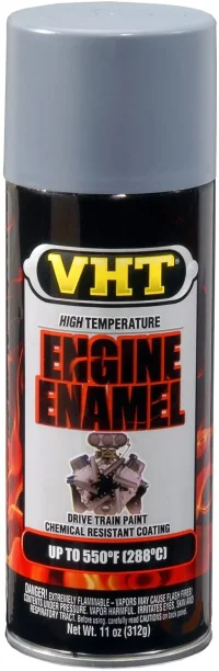

Enamel HT Primer - Recommended:

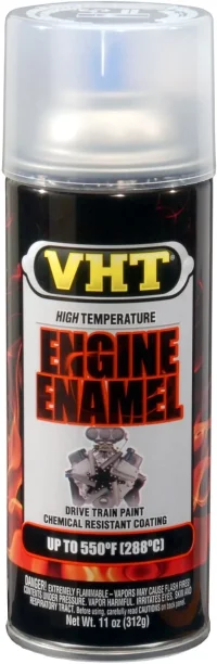

Enamel HT Clear-Coat - Optional:

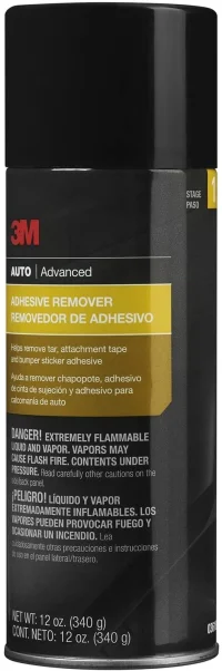

The "Aww Shieet I Messed Up Fixer Upper" - Recommended:

- (1) CAN "ASIMUFU" (3M Adhesive Remover) or ANY LACQUER THINNER. I just happened to have this handy working on some other project.
- Applicator pad or sponge - This is to pair with the 3M adhesive remover

- Violently shake the primer can for 30s-1minute. Spray one or two mists to ensure spray is proper.
- In a SWEEPING motion (i.e. start in the air and bring your hand down towards the exhaust tips) begin painting the exhaust tips with primer. A LIGHT coat is recommended but at this step it shouldn't matter.
- Remember, keep steady and don't linger in one area for too long!
- Once all 4 exhaust tips have had their first coat applied, wait 10 minutes. Should be a 3-4 minute wait until the very first one is due for the second coat.
- For the second coat, repeat step #9 whether you applied a LIGHT coat or MEDIUM coat. If you've applied a HEAVY coat, I would just do 2 coats of primer per tip.
- In a SWEEPING motion (i.e. start in the air and bring you hand down towards the exhaust tips) begin painting the exhaust tips with black enamel. A LIGHT coat IS STRONGLY SUGGESTED - practice using the paint can on cardboard if you're uncertain of how you can change the degree of coating using the push nozzle. You should have figured it out when applying primer 8 times.
- Once all 4 exhaust tips have had their first coat of black enamel applied, wait 10 minutes. Should be 3-4 minute wait until the very first one is due for the second coat.
- Repeat Steps #12 & #13 with a LIGHT coat
- Repeat Steps #13 & #14 with a MEDIUM-HEAVY coat

17. Once the exhaust tips have dried for 30 minutes from the paint. You may use the optional clear coat for a better shine/gloss finish - apply 1 to 2 coats.
