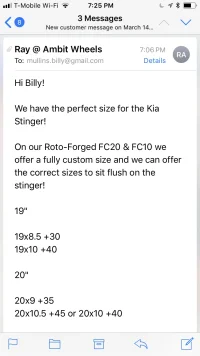

I need to know what 19 or 20 inch wheel sizes I can run on all 4. I can’t have staggered with all season tires in the mountains. Any ideas on size?

If u are going for non staggered, your choice will be much more limited which will also make your selection easier in a way. Firstly, using front as a guide, u can choose either 8.5" or 9" width. Going too wide will have knocking issue when turning. Next is offset. Depending on how flush u want and whether u are going to lower your car. If you are not lowering your car, the following should work.
19x8.5 ET30
19x9 ET35
20x8.5 ET30
20x8.5 ET35
For tires, it is another calculation. You will need to ensure diameter stays near our stock setting of 660mm. For eg choosing 255/35/19.
Hope these help

If not lowering can we stay with the stock tire profile with 20" rims to fill gap?
No I’m not lowering it and I went to Car ID.com that a car shop told me to put the stinger in and it will get me all the Rams 1819 and 20 that will fit the car so there’s actually quite a few options

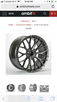

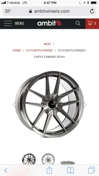

984BE756-B166-4F19-981F-53E3891EE763.webp DF783C36-F77C-423E-834B-7E024564793C.webp 53AFD238-4973-4D3A-92CB-86C51B858603.webp I worked with these guys on a set of wheels on my Miata track car. Love that they are flow formed, rather than cast, so in theory they are both lighter and stronger. And if you notice their prices, they are petty reasonable, and will also do custom colors.
