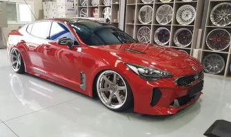

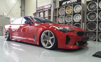

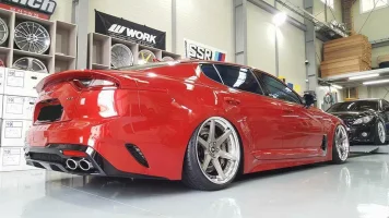

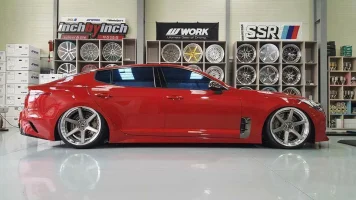

Nope, just triple Bronze, it's a matte finishTriple bronze=bronze chrome?
I have 10.5+45 and they're super flush, probably still inset a little bit because the tire is flush with the fenderI've got their HF-1 wheels and love them. Think I may downsize my rears to just 20x10 +45 because 10.5 is poking a little more than I thought it would but aside from that, the wheels and their service has been solid.
just saw this again, and till love itNot planning to lower my car. Thanks for the help!
I probably look at these weekly manHeres are some pics I took on my phone. 20" TSW Sprint with Eibach springs. Love the staggered look. Spokes have a cross cut (the hole) on the side, nice detail.

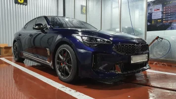

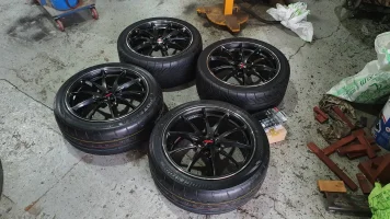

Wheel/size/offset and tire/size/profile...can be confusing.Hi guys,
I'm currently running my OEM wheels on the winter but looking for a set of 20's when the summer is coming.
Found a nice set with 20x8,5 with ET38 in the front and 20x10 with ET43 at the back. Will this setup work without any spacers doing 245/35-20 and 285/30-20?
Don't want to buy the wrong because wheels and tires a fairly expensive here (around 4k USD for the above).
Thanks in advance.
Howdy and welcome. Lots of discussion about this, as in the link posted by @YOWStinger. But the short answer is: it varies manufacturer to manufacturer; offset and rim width are only the two most important, starting factors. Tire size plays into it, so, choose wisely. I let the wheel and tire pros answer these questions: and they steered me right. They will have to pay for any goof that they do, vis-à-vis picking something that ends up rubbing. If you order online, go it alone, you are in trouble if you mess this up (as with all things).Hi guys,
Thanks in advance.
You are correct, it could be pretty close depending on the profile of the spoke. My 9+35 are pretty close to to the caliper, but apparently the TSW Sprint 8.5+40 clear the caliper, so it's really going to be hit or miss with that offset. If you love it and there's a good return policy, order em up and test fit them without mounting tires on them, most manufacturers and shops will let you return them as long as rubber hasn't gone on.Thanks for the reply.
My biggest concern is that the spokes might rub the Brembo brakes when going for ET38 (8,5" thou)? Think the standard offset is like ET34?
Your 245/35 285/30 could also be hit or miss too, however, the 20x10+43 are going to be more inset than mine, mine just clip the fender liner (doesn't touch the fender) at 10.5+45 and I get some minor rubbing under heavy compression, you might just clear that and not get rubbing with that tire size. If you can stand a little rubbing, I do highly recommend those tire profiles, you get nearly stock profile so the 20's run really smoothly. There are other options that are closer to stock diameter that you can go with too that won't rub.
My 8.5" wide, 19" rims in front have 40 offset; and the TSW "Watkins" spokes are very close to the caliper, but clearance is no problem. The pros gauged that to a nicety.Thanks for the reply.
Damn. Not the answer I wanted. But thank you for the information![]()
