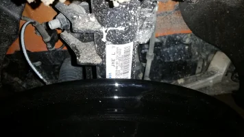

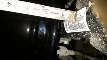

This was my front without 5mm spacers. Couldn't get cardboard from a cereal box through.

The point I was trying to make is that if I am that close to my caliper and not rubbing anything, then it looks to me like the caliper would rub before anything else.
I don't even know where I am looking in that pic of yours!? That looks like a blurry closeup of the valve stem!? How is that possible? (Not being a car guy is so limiting at times like these.:rolleyes: )

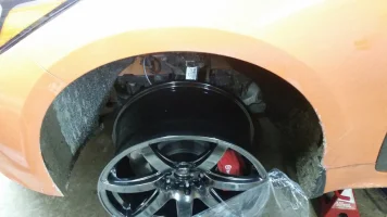

I happen to be installing my new wheel setup and snapped a few pics to help clear up the strut clearance we are talking about.

The wheels I just got are 18x8.5 et 20. I would not want to go any lower offset as the outward fitment is flush/slightly poking with the body. I would probably go with the ET 25 but I like a more aggressive fitment, I think most on here would say to go with the 35. The 35 will be ~.6" closer to the strut than what I have pictured above. So very close.
