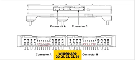

    Am I missing something here? That harness wiring diagram must not be for the 15 speaker HK system is it?

    The image in post 12 and 16 is correct for the HK system. At least on my 2018.
    The orientation is confusing, look carefully at the amp orientation. Connector A in the image is actually labeled with 2 on the harness. Connector B is labeled with 1.
