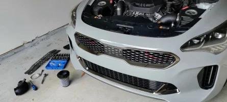

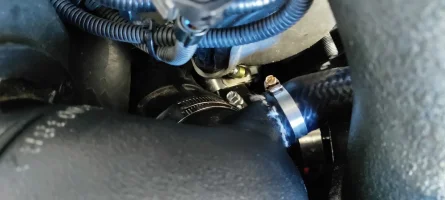

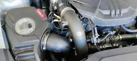

I'm cleaning my air filters currently. Just wanted to let you all know that both the aFe intakes and charge pipes fit fit nicely but they're tight. Accessing the passage side intake with the cold side charge pipe installed WILL BE a pain in the ass. It's doable but it's a chore.

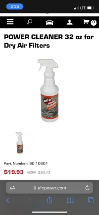

Did you use this spray off the website to soak them down and then let them dry? On the site it mentioned every 15-20k to clean… is that sufficient ? And how is that charge pipe from Afe working out for you?
No, I didn't use the spray. I actually have to buy some lol. I just knocked off loose dirt and vacuumed out the airboxs. There was a good amount of dirt that I was able to knock off but the inside of the filters were still very clean.
Since you are running ram air ducts like me I would recommend checking for any debris buildup every 1k miles. I will do a deep clean with the spray every 6k miles, that'll be my cleaning routine.
I really like the charge pipes. I have both the hot and cold side. I feel that the boost delivery is smoother overall.
I'll probably wind up ordering an extra set of filters + the cleaner spray when the time comes. I figure the spare filters will come in handy in case something comes up causing me to drive before the filters would normally be completely dried.
