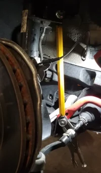

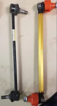

Hey All,
Got my hands on some adjustable End Links from @NICK_KHAR KHARTUNERZ. I highly recommend installing these if you have lowered your car and are on aftermarket front sways. This really helps to get the geometry of the sway bars back to optimal position after lowing the car and giving you the full effect of the sway bars.
Here are some pics of them vs OEM:
As you can see these are a much beefier end link and if you are an coilovers and want to corner balance your car this should be a must have to get rid of the preload.

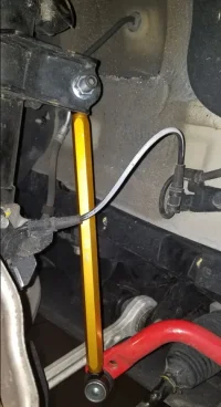

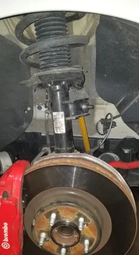

The Eibach sways are great but these take them to a new level. Here are some additional pics:
While I was in there I also changed my pads to the Stoptech Street Pads. Ill do a review on them in a few weeks especially after I hit the track at the end of the month. I will say they do have a better bite, but can be a tad bit nosier when you release the brake at stops.

Looks awesome! Stoptech makes good stuff too.
Just installed mine man it makes the car feel solid at cornering. Also khartunerz always has fast shipping.

Did you do the rear end links as well?
Nick can get these. Getting mine now lol.
Please review once fitted, I’d be interested hear your opinion once you have driven the car with both done in conjunction with the sway bars.
@DaBears4Lyfe question regarding this Aftermarket End Links, did you make adjustments when you installed them or you just leave it as same length as the OEM?
