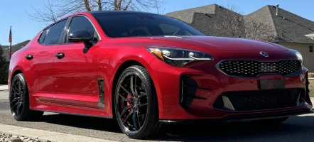

The rears are TIGHT! With 295's on the 11' wheels, it actually rubbed the insulation off of one of the wheel speed sensors and starting causing a fault. I had to slightly bend the bracket to provide millimeters of clearance. Other than that, no issues with anything. My car currently sits on stock suspension, but I really want to drop it a bit. Attached is a better picture. I am considering ARK-GTF springs. Previous to the wheels I have now, I did have 20mm spacers on the all fours corners with stock wheels. The back wheels sat perfect, but the front did "poke" just a bit more than I liked, in my opinion.

20x9 +35 offset up front and 20x11 +50 offset in the rear. No spacers. I think it's a perfect fit! I say go for it!

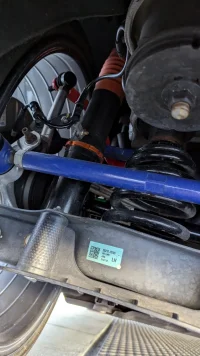

10.5 45 with 285 lots of room to spare its all about the back spacing PXL_20240802_231054376.webp
Oops looks like one part of my math was bad, I must've used 9.5" as stock rear instead of 8.5". So an 11" +50 is 2.5" wider than stock, and mounted 3.5mm further out (vs. stock +46.5 offset).
So outer edge is 28mm further out than stock (good bit further than stock wheels with 20mm spacer), and inner edge is 35mm further in, as @ElChanclo mentioned.
