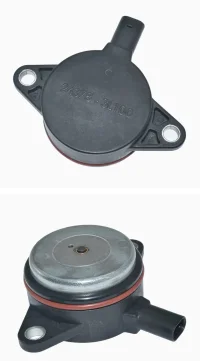

Ok, I'm here to deliver:
Problem was misfiring on cylinders 2-4-6 (One Bank only)
They found the issue to be coming from the variable force solenoid (P/N: 24379-3L100)
Here are the list of things they checked before getting to the solenoid:
1.) Inspected Gas. found to be ok
2.) Reset engine and adaptive values
3.) swapped coils 6 and 5 and spark plugs 6 and 1. Test drove. Misfires on 2,4,6 still. no change.
4.) Inspected wiring from coils 2,4,6. Measured their resistance values and all within spec.
5.) inspected for pinched wires. None found
6.) removed O2 sensor on left side and inspected Catalytic converter. no debris no clogging found.
7.) Swapped VFS(variable Force Solenoid). there are two, one on each bank. Test drove. Misfiring changed from 2,4,6 to now misfiring on 1,3,5
So they replaced the faulty VFS and misfiring went away.
I also talked with the tech and walked me through what he did and I'm pretty convinced that it is now fixed.
He told me that he had to drive the car for a while 20-30 mins in order to get the misfiring to come up.
Will report back if misfiring comes back.
I'm very happy with the work they did and happy that they went through troubleshooting process with me. oh and they also did the recall work too (SC300)
