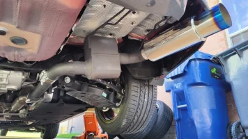

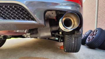

I agree muffler deletes in general are horrible. However, inline4 exhaust can be done well and sound relatively good. I did this custom axle-back for my son's G70 last year, and he has been very happy. At idle, it is almost stock quiet. Low revs adds a low throaty growl. Higher revs does bark a bit but not at all obnoxiously loud.
I myself prefer stock quiet, but my son wanted a bit more "character". Besides, the stock exhaust was a boat anchor. One added benefit at the track is that it helps to hear what the engine is doing without needing to glance down at the tach.
Prior to this, we did a quick experiment with just the same end can resonator on our Stinger 2.0T, and it was too loud and wayyy too much drone. Unlike the 2.0T, the 2.5T does have a resonator, so that should help a lot. However, I still think you'd be better off with a small muffler. I went with a Flowmaster Super 10 on the G70.
Very helpful, thank you! I’ll look into that muffler. Do you know the make/model of the end can resonator?

Lol... My son drives the G70 and he doesn't mind, so I'm okay with it... since it does not sound like the typical Civic raspy high-pitched whine. Although, he is now rethinking the exhaust outlet, so we are planning on switching to a dual tip that matches that stock exhaust cutout better.
