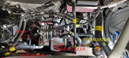

I believe that the coolant for the intercooler is pumped by what appears to be an electric water pump mounted to the top of the air to water intercooler. I'll try and include a picture that will hopefully show this. I supercharged my 2015 Civic Si and it uses an electric water pump to pump coolant through a separate circuit through the aftercooler. My civic's setup has a separate heat exchanger/radiator mounted in front to cool that fluid. I haven't followed all the lines on my Stinger yet, but I'd assume they'd use a separate circuit. Not sure if it has any additional heat exchangers hidden away, but I'll take a look once do my first oil change.Stinger intercooler and electric water pump.webp

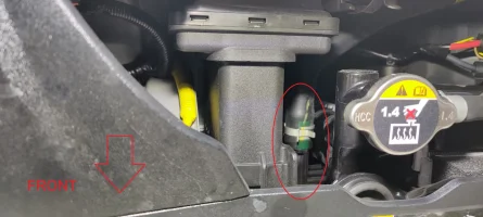

I poked around a bit under hood to get a better idea how the intercooler is set up.
Novo above is correct about the water pump near the top of the intercooler. It will be highlighted in the pic below.
There appears to be another radiator in front of the primary radiator. It's hard to tell but there appears to be distinct tanks for either. The pic below shows the view near the pass side looking down. The hose with the green squares is one with the label L450 in the 2nd pic coming to/from the pump.
I don't recall where the hose labeled J50 goes to. I believe another fitting on the radiator
