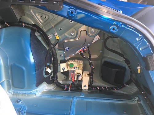

I have the base model and could not find a amp anywhere and I looked in the trunk, do you know where it may be located?
buried in the dash would be my guess.
It's not in the trunk behind the panel on the passenger side?
For the HK system it is above the fuse box.
no I have the base model and it does not come with the HK stereo
so we need to find the pesky miniscule amp for the base model.
So for clarification, it is not in the same spot as the HK amp?
The pinout diagrams for the 2 amps look so similar that my assumption was they were in the same place.
i reached my hand up and above and around and I did not feel anything, i will have to take the lining out to make sure I let you know
