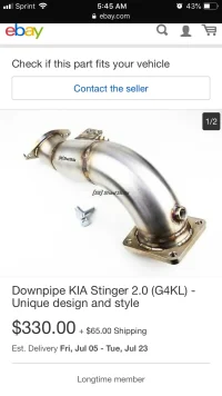

Is this downpipe fitted to the stock exhaust? Or is there an cat back you are already using that fits the downpipe? I guess my question is what aftermarket exhausts does the down pipe fit? If anyone knows that information.
the downpipe will fit on the stock exhaust. no problems there. It is a direct bolt on.

Have you attached this downpipe without any issues besides the code? and can you post a link to this?
Heres the link to the product.https://sharkracing.com/2018-stinger-2-0-performance-downpipe/
