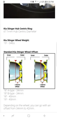

Will 38mm offsets on 8.5 and 9.5 wheels fit decently? I believe the stock 19's are 30mm front/45mm rear On the RWD..I think the stock 19's are 19x8/8.5. I believe this will slightly suck the front wheels in and push the rear out. The stock rear wheels could probably use a 10mm spacer to sit more flush anyways. I would be reusing my stock tires and buying new TPMS valve stems to swap the sensors over. Aluminum 67.1mm-74.1mm hub centric rings are less than $10 a set so that's not a big deal. I think these would look perfect on my 2019 Ceramic Silver GT1 RWD.. thoughts?
TireRack to put together a set with 32mm front and 38mm rear offsets. $868 shipped with the hub centric rings and lug nuts. Hmmm. That would fit much better.
