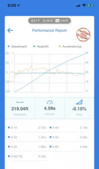

I can’t speak for anyone else’s car. However, my best 0-60 mph time with my Stock 2019 RWD GT2 Stinger was achieved with “9 miles to empty” showing on the gauge and 87 Octane in the tank. It was a cool evening so 93 Octane wasn’t necessary with my stock engine.
Now, 4.59 0-60 mph isn’t the best a stock car has ever achieved but it isn’t bad. If it had been reducing performance it would have been a whole lot longer than that.
I don’t know what happens once you modify the engines but I can unequivocally say that my stock engine has performed the same regardless of how much fuel was in the tank.
Here is my best dragy result with an extremely empty tank. I immediately went to go get gas right after this and I almost ran out of gas.
