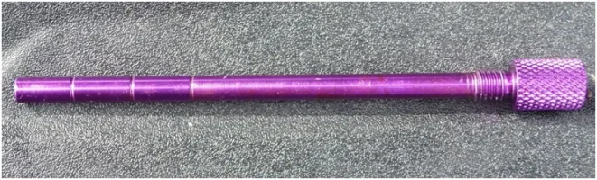

Checking the dipstick in the cans after 6.000 km, indication is, there is about 1 ¼” of stuff in each of them. It smells like oil diluted with gasoline. I have not emptied it, because it’s too cold to work on the car.

One Of The Dipsticks - The Can is filled to the top indicator line = 1 ¼”
