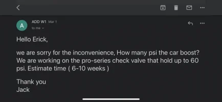

This is what the company told me back in March so I guess their working on new revised check valves that won’t fail so easily
