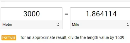

Ah.. you posted 3km.. figured that was a little premature.
LOL, actually I wrote "3000m", but intended the "m" to represent "miles". No worries, we all got to the same place :). Now any other feedback/experiences with these issues?
Thank goodness it was "m" and not "k".
