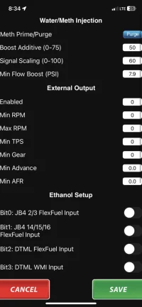

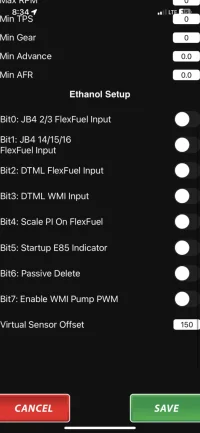

Hey guys! I just installed a BMS WMI kit, and when I go to purge, I can hear a click but the pump doesn’t kick in! I tested the pump separately and it does work, I was wondering if you guys had any ideas? The FSB is blinking red when I try to do the purge, I have a feeling it shouldn’t?

Make sure you have map7 set, it doesn't purge unless you have map7 set.
this is partially correct, it will also purge if you have the bit selected that allows for WMI with external inputs such as ecu tunes from other companies.
