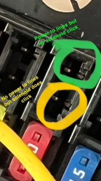

Hello everyone,
So I bought a wmi kit and got everything hooked up. I went to purge and nothing happened. I checked to see if all the wires had power, made sure my pins were in 3 and 16, made sure my grounds were good but still nothing. I remember reading if nothing happens then check the fuse, so I did. I switch the fuse to the opposite side then got a click from the solenoid but then my other wires had no power. Switched the fuse back to the original side I had it on then the opposite happen... power but no solenoid click. Does anyone know what I'm doing wrong or missing? And yes I'm on Map 7 and input all settings. Thanks!
IMG_9375.webpSo I got a fuse tap because I thought if it's touching both points then it should work... hell nahh, it's the same thing with the tap. If I flip it one way or the other it does the same actions above

I ended up figuring it out last night. I went and bought some new fuses and put the fuse tap in a different empty spot then it worked
