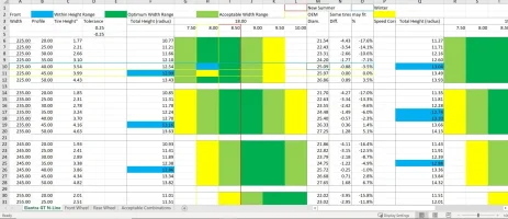

The specified size of tire for 18 inch wheels is 225/45R18. I have a set of 225/40R18 from my Forte GT. Will these work on the Stinger? I know the speedo will be affected slightly
That’s great. I already have the rims which will fit. Thanks a bunch.
Yes, should work. It's what I'm planning to do. Will lower the car .44" and speedo will be off 3.5%. I have some studded Toyos I'm going to run.WheelsandTires.jpg
