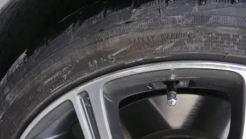

My first winter with my Stinger is nearing its end. I've kept the OEM rims throughout; put Nitto Motivo UHP A/S tires on at the beginning of the winter weather.
I wonder if the lack of the Michelin "V" ridge that protrudes beyond the rim has contributed to what I just noticed hugely this morning.: "rash", all on the left side.
Of course, this only means that the car wash guide rail has scraped my slowly turning left side rims. You can see that the damage does not extend higher on the spokes than can be accounted for by the height of the guide rail. Shit. These pics are all of the LR rim; it's worse than the LF rim for some reason: probably a quirk of the conveyor keeps the front slightly away from the guide rail, while pulling the rear wheel against it. Shit.
This was my most untouched rim until this happened. I don't know when it happened. I only know that I had my car in Magic Clean the last two days in a row. It looks like some idjit caught the end of the guide rail with my rim at least once. The rest is just rolling attrition damage. Shit.

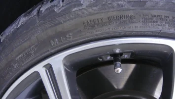

At this point I am thinking of buying spiff "summer" rims and putting my Michelins on them, and as soon as I know the salt on our roads has diminished enough, swap out the OEM rims and Motivos for the summer tires and new rims that will NEVER see the inside of a car wash ever in my life. Just as soon as the salt goes on the roads next winter, out come the Motivos on the OEM rims and they can get carved up some more: at least they will mostly look pretty good for a winter ordeal: I can sandpaper and wet sand them down enough to look even better: this job a few days ago took all of fifteen, twenty minutes. Passes the "five feet away" test. For winter, that has to be good enough for my high performance daily driver! (LF, curb rash, my fault; the left side of my car hates me:rolleyes:)
Before I thought of a second, "summer" set of wheels, I figured I'd just have to suck it up at the end of each winter, take my rims to a wheel restoration outfit and get them looking pretty again: for several/many hundreds of dollars. I'm not in love with the OEM GT rims that much! I'd rather just go over them myself for free, and replace them when the winter war is over.

Wheel restoration is rarely cost effective these days, so in your case, for a DIY fix, there might be a couple amateur routes that will give mixed results. First, you can try for a full restoration by sanding the damage down, filling with bondo and then re-painting the wheels. This option means you would need to pick a different color to spray the wheel, you'll never get the natural metal finish back. The second option, since you're changing colors anyway, is Plasti-Dip. It doesn't last forever and it wont necessarily hide your gouges in the wheel, but it will make them less obvious. You can get pretty adventurous on the color these days and get pretty satisfying results. It is also not overly expensive and it's quite easy to spray on, just make sure you spray enough, about a whole can per wheel. The benefit of Plasti-Dip is if you decide you dont like it or want a new color, rip off that rubber coating and start over.
BTW, there are many sources of this "Dip" online, you're not limited to the actual Plasti-Dip brand, this opens up color options.
Actually, the OEM GT rims polish up with wet sandpaper pretty well. The "five feet away rule" doesn't notice any glaring discoloration, even over time.
This "dip" method looks/sounds intensive. I have to take the wheel off and mask the tire. Annoying. But it would be worth it, if the sanding method didn't fix 90% of the problem. We're just lucky that the clear coat on the OEM GT rims doesn't change the natural alloy look.
The biggest problem in all of this "restoration" crap is when the alloy higher areas get scrubbed down into the gun metal lower areas. There is no easy fix here. If I sand the splayed alloy down, I've ruined the gun metal, requiring a further repair/repaint of the gun metal. And I haven't even found what touch up paint color that is yet (tried months ago here and got no joy).

I think you have done a great job on photos 6 to 7 with the standing.

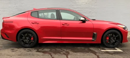

IMO, have two sets - invest in a set of winter wheels and tires. I'm a big fan of the OEM wheels. I have AWD with the 18's. And even though I have all-seasons, I decided early-on to buy a winter set. I not only want/need winter tires where I live, it is WAY too easy to muck-up the wheels in winter - easy to slide into a curb; all that salt, grit, and grime.... plus things like those frequent visits along the rails of the local car wash. Even if you don't need true winter tires, you can have A/S for your 'winters', and a nice set of summer UHP's on the OEM wheels for warm-weather months. My $0.02
Just to add... my winter wheels/tires are the default recommended set from TireRack - Mich X-Ice's with a 'cheap' set of steel Sport Edition A8-2 wheels for $140/per... but the look pretty nice...
