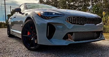

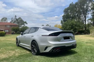

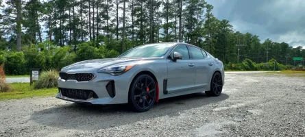

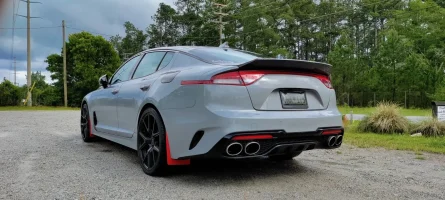

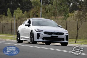

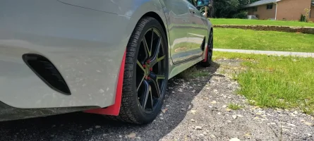

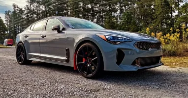

I know, year old post, but would you happen to have pictures of this fitment?
I'm running 245/35Z R20 in the front and 285/30Z R20 in the rear. All 4 wheels are 20x9 with a +34 offset
