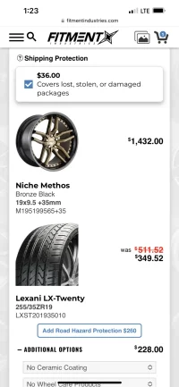

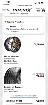

Hey guys, not sure if this would be the right place to post this but I’m a bit lost when it comes to this stuff. Would I run into any issues running this setup on a 2020 AWD GT-line? I do have factory brembos installed already, not sure if it’s relevant to this but figured I’d add it.

Would I be better off running this setup then?

So will I run into any fitment issues with 19x9.5 +35 and 255’s? I just really want to make sure before I drop over 2 grand on them.

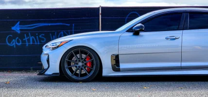

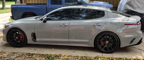

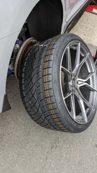

Rwd GT1 Currently running 20x8.5 et40 on 255/35r20. No rubbing at stock height. About to lower it on ARK GT-F spring so we’ll soon see if my tire choice is too aggressive.
Rotary forged TSW Bathurst
20x9 +30 and 20x10 +40
