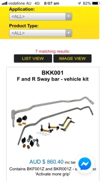

Just came across these on their website, they have now been released by Whiteline for the Stinger.

I ordered a set of these yesterday after seeing the announcement on their Facebook page, and because the Eibachs are still on backorder in Australia. These are two way 24mm and 18mm bars, vs the 25mm and 19mm two-way Eibachs.

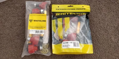

Well, the courier just arrived with them, which was a bit unexpected. They look nice, and include not only the BKF001Z front and BKR001Z rear sway bars, but also adjustable end-links (KLC180-115 rear and KLC180-195 front). Unfortunately, the Stinger uses the KLC180-295 links for the front (the 195 is for large SUVs like Pathfinders and are a lot smaller) so it looks like kit was incorrectly packed. Oh well, I've contacted Whiteline and will see what they have to say.

Just heard back from Whiteline, who say they will courier me the correct 295 kit. Hopefully this is an isolated case!

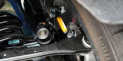

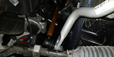

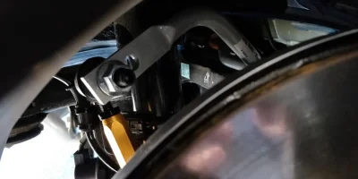

I got a chance to do some more spirited driving around corners today, and I'm definitely impressed with these sway bars. The car is much flatter and feels more composed around corners, with less body roll. It still feels like a big car, but no longer sways like a boat. I also managed to push the car harder on corners without the rear end getting as 'floaty' as it has been. I'm not going to push it too hard, and will gradually increase my cornering speed and acceleration over time, as I don't want to go to that Mustang life. As expected, there is zero penalty for these improvements and the ride remains as smooth and quiet as always (I also coated the trunk with dynamat, and added a layer of acoustic foam on top, over the weekend).
The bars are both at their softer setting, and I don't see any particular need to go hard with a GT car, at least not until I've had a chance to try out some more challenging roads (and maybe wait for summer for that).
I also like the fact that you can see the gold rear links through the rear rotors, for that extra bit of bling.
