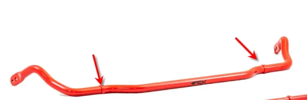

Had factory end links replaced with whitline adjustable end links connected to ark front sway bars when installed did not hear any noise hitting bumps but now after about 2 weeks noticed end links hitting the control arms anyone else had these problem they where adjusted same length as factory ones do they need to be shortened ?

Pics?
Looks like your sway bars DO have integrated provisions to prevent the sway bar from walking left/right.
I can't imagine how this new interference could have developed over 2 weeks.
you can definitely adjust the length to your preference
Shop adjusted them they think hit pot hole or something they shortened them about 1/4" not hitting control arms now.
