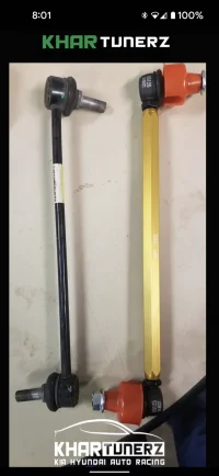

End links are a must they will flex just be sure to zero them out with the car sitting on the ground.
So the endlinks do provide stability ?
I had my Swaybars fitted in 2018 & then the endlinks fitted in 2019 & noticed the improvement straight away so IMO yes the upgraded endlinks help firm up the stability of the car when cornering & really compliment the upgraded Swaybars.
