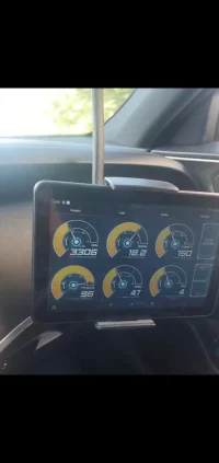

So, I guess you can't do video. Here's a screenshot of my JB4 gauges the moment I hear it. Again, it comes and goes and it sounds like it's coming from the front of the car. This is slowly increasing my foot pressure on the accelerator.

This is full throttle, pedal to the floor from 30 to 90mph. JB4 logs are good per Terry

I'm not sure exactly what that sound is, but it definitely doesn't sound normal to me. Seems like it's when your boost gets around 14+ PSI (top middle gauge is your boost in PSI I'm assuming) you can start hearing that whine/squeal.
