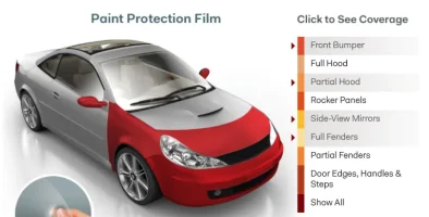

the highlighted areas on the photo posted are the main ones, the only thing I would change is, instead of doing the partial hood, I'd cover it completely.
The side air vents do see some debris, however it is not enough to cause any damage to the sides of the car.
The areas in the lower quarter panel and rocker panels, near the rear wheels, are considered a high impact area, and Kia actually puts ppf there, whenever you add the paint protection package on their site. If yours doesn't have protection there, I would add it too.
I don't think the full fender is worth it. I'd do the full hood before full fender.
