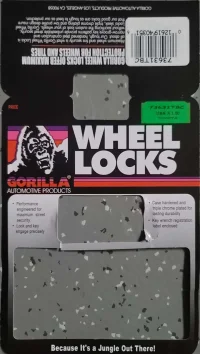

Where to get Stinger wheel locks? The dealer threw a set in the trunk, but they were the tapered kind.
Just checking, did you verify that your wheels need mag nuts and not conical?
a) go back to the dealer and tell 'em they tried to destroy your wheels and get a correct set
or
b) go to any auto shop. Take one lug nut off to make sure you get the right threads. Should be m12x1.5
Go back to the dealer and get the right one.
I had to deal with this with my dealer. Apparently the mechanic installing them knew they were incorrect, but because KIA only has the one part available and lists them as the correct one,the parts manager actually threatened to fire him if he refused to install them.
I did my own research and bought a package of Gorilla brand nuts listed for Toyota trucks and they work perfectly.
If they refunded their mark-up for wheel locks, I'd say you came out way ahead.
