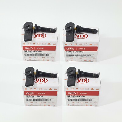

PS: I bought a second set from ebay - Genuine OEM TPMS Sensor Valve 52933j5000 QTY = 4 for 2017-2018 KIA Stinger G70 | eBay

Go to a wheel shop and have them scan each sensor.
My wheel and tire guys have a handheld scanner tool and it can show if a TPMS sensor is sending or not; it can also reprogram the sensor.
