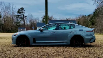

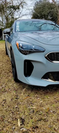

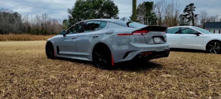

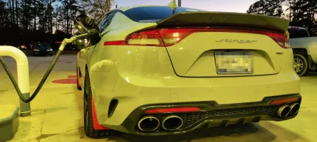

I run 235/35 R20s in the front and 275/30 R20s in the rear, for a square wheel setup with staggered tires. Both wheels with +34 offset and stock ride height (not lowed).
Looks nice i really like the stance..not really sure just yet on what Iwant..thank you for the input!
