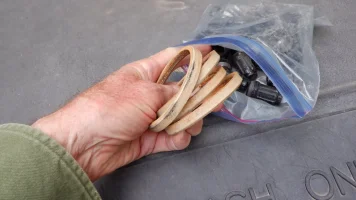

I just want to lower the measurement since the wheels are too far out but not in a way that it looks like a jeep wrangler or anything. It's just that when it rains, the dirt really go all over the side of my car and I'm just scared that rocks might chip on the side and damage my paint.Not a big difference in size, but I’m running these from Amazon. I posted this in another forum, but I have no problem repeating that thear are the same 20mm spacers found on Khartunerz for 1/4 of the price.
