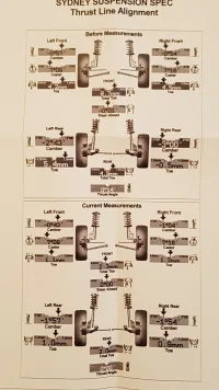

20190312_162738.webp Im not sure if this is of any help. This is a before and after. Im on Eibach springs.

Hi Geoff,
Here’s mine from last June, car is not lowered, still on OE Springs.
That's pretty funny. He's asking for specs and your sheet is blank. What specs did the shop you used reference when they don't appear to have any?

Yes it is pretty funny isnt it, I’m not a tyre aligner I just gave him the before & after results of my wheel alignment thinking that would be of assistance, but we are not all experts in everything are we.
You may note he stated “any info would be appreciated”.
