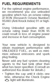

Owners Manual says 91 AKI (Anti Knock Index), which is what is used in Canada and the US.
Ok, I get that. But 91 in Miami = 87(or so) in Denver......(Out here is basically 85/87/91). So then, 87 best here at 5000+ feet or, would I still be better off with 91 at 5000+ feet.
