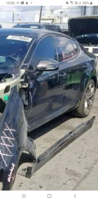

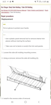

Hope this helps.

Thanks to all who replied above. It's hard to tell from photos - I might need to get my KIA service centre to take mine off so we can have a closer look. Thanks again!

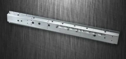

This is NOT from a Stinger but should give you a better idea of what the Stinger ones would look like - It's a panel designed to add strength and provide mounting points for the skirt. It's not designed to be exposed to the elements.
The Stinger side skirts aren't attached over a "normal" sill/rocker panel, they are the panel.
