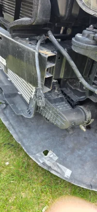

SiriusPilot
Took the bumper off to replace the fog lights and saw this, anyone know what it is and what it plugs into?

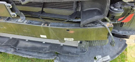

Did you happen to notice if your dash displayed the outside temperature? If that still showed, then that disconnected AC ambient temperature sensor is literally not connected to the outside temperature sensor that displays on the dash. You've made me casually curious and Ima just asking questions to answer this one.I've only had it for 2 months and found that the guy that had the car before me did a lot of messing around with it. I took the bumper off to replace the fog lights and found that dangling along with a lot of broken vent clips. So either him or when I blew off the hot side intercooler hose. The clip for it, where its supposed to pop in is loose so I just zip tied it and no problems.
Maybe I'm reading this incorrectly, but I interpreted it as the sensor itself was not disconnected electrically from the harness, it just wasn't snapped into its mounting location. So functioning, but dangling.Interesting. So, the outside temperature sensor is something/somewhere else. A search doesn't turn up anything to point to a Stinger sensor location, or even what the sensor looks like.
That makes more sense. The appearance of the dangling sensor looked like a disconnected plug to me and I didn't even question it. Hah.Maybe I'm reading this incorrectly, but I interpreted it as the sensor itself was not disconnected electrically from the harness, it just wasn't snapped into its mounting location. So functioning, but dangling.
I'd always understood that to be the source for the outside/ambient temp displayed on the dash, since pretty much anywhere else but out in front of the car would be impacted by its own heat.
In the first pic, it looks like the temp sensor is there, plugged in to the harness. The previous owner just didn't bother snapping it back into the proper location. Lazy.The outside air temp sensor is the thingy that is at the end of that connector. It's probably just an RTD. None of them are very large. That wiring harness is normally clipped to the front radiator support so it sees the incoming air.
