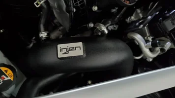

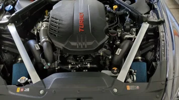

So your car doesnt have any aftermarket mods like intakes or BOV's? The sound is normal in my opinion but it seems loud on your car if you dont have any mods. Did you buy your car new? Can you post a photo with your hood open so we can see?
I have noticed the same thing since putting on my Injen intakes. Most of the time even when driving hard, flooring it, releasing the gas pedal rapidly, and so on... it will make the normal pfffssshhtt sound, but every once in a while it just lets out this crazy loud chirp. I honestly thought maybe one of my hoses or couplers wasn't tight enough and was letting some air escape when the pressure is too high causing a chirp. Honestly just have no idea what causes it.
Aha. Thought those were stock but after taking a look under the hood I definitely have Ingen intakes. Funny, I used to do a lot of my own engine repairs years ago, mostly simple stuff like carbs etc. but now I look at an engine and I have no idea what's in there.
I bought the car used from a dealer... makes me wonder what other mods the previous owner did. I'll have my mechanic take a look the next time I bring it in for service. Thanks for all the replies, that was really helpful!
That explains it, the noises you're hearing are totally normal with those intakes on. The good news is I don't see any old adhesive marks on your fuse box on the top left, old adhesive marks from velcro would usually mean someone had a JB4 tuner installed.
