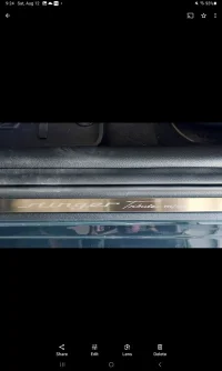

New to the Stinger World. Just went all in and upgraded from a 2021 K5 to a Stinger Tribute. What are the best bolt on upgrades to get a little more juice out of her, not looking to mess with the electrical and splice in a tuner.View attachment 81783

Msrp, same as building it on the kia website.
