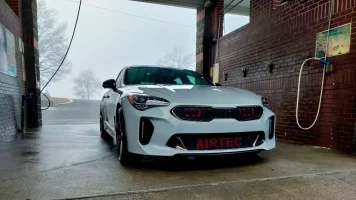

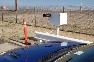

This morning, I went to fill up on gas and weighed my car on the CAT scales. Here are the results.
2022 GT2 rwd
Front: 2080lb
Rear: 1880lb
Gross weight: 3960lb (full tank of gas)
Mods/weight savings
245/35Z R20 front
285/30Z R20 rear
Voxx Modena 20x9 wheels 26.6lbs each
Exhaust setup around 29lbs lighter
removed spare and spare kit around 39lbs lighter
AirTec intercooler weight 21.8lbs
Cquence Street Performance brake rotors are a few pounds lighter than stock
Seibon Carbon deck lid spoiler
Carbon trim overlay
JUN B.L Racing Catback exhaust
JUN B.L Secondary Downpipes
NGT HFC Primary Downpipes
ATQ Subframe kit
Mishimoto Oil catch can
Velossa Tech air ducts
AFE Power Intakes
AFE Power hot and cold charge pipes
Shark Racing Big Bore Throttle Body
1 inch Phenolic intake manifold spacer
AIRTEC Intercooler
Lap3 1.5+ ECU
HKS M45IL Spark plugs
BMS Vanity covers
RokBlokz Mud guards
Cardon fuel door
BMS Differential brace
BMS Kickdown blocker
K8SS Elite Sport Ceramic brake pads
Veronix upper grille
Mesh Lower grille

How accurate are those scales? I found a performance shop that can weigh my stinger, for a fee.
Well, that is interesting fixation stuff. Rather analogous to the woman who measures her body with a tape measure and monitors her muscle/fat index. My Stinger is "fat" because it has a sunroof and AWD and I keep the spare under the hatch, also my hatch is mostly full of "stuff". And soon I am going to put the boat anchors back on. Ha hah.
I was curious about the GT2 RWD weight. I've never been able to find solid information about the RWD curb weight, always the AWD.
I've watched some video about people who've get their cars weighed on the CAT scale vs scale meant for performance applications. The CAT scales seem to be about 15 to 20 pounds off. Close enough
52.5 / 47.5 front/rear split, which is in line with the 52/48 I've seen elsewhere.
Obviously you've got some weight changes that affect the balance (spare, intercooler, exhaust) but nothing that seems like it would swing it a ton in one direction. Wonder if anyone has put a concerted effort into hitting 50:50...couple hundred pounds from the front half of the car would be a challenge.
Thanks, I would like add CF fenders to lighten up the front some but I imagine someone would need weights in the trunk to achieve 50:50
5 years ago, I took this picture on the NHRA certified scales at Wildhorse Motorsports park. For reference, my 2019 GT1 was bone stock, fully wet.
Awesome. apparently my car is 61 pounds lighter than a stock GT2 RWD. I'm surprised how close I am to the GT1 in weight.
