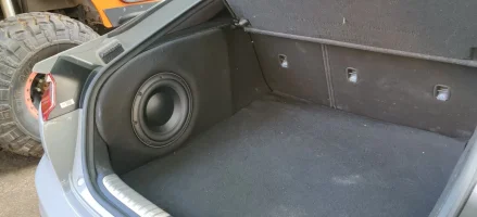

I eventually decided that wasn't enough and went with a 10" sub. I built a box that uses the space behind the wheel well, so cargo space loss is minimal. This is definitely not low effort (or low cost if you lack the tools/skills to DIY).

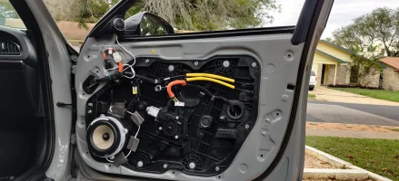

Most of the factory bass actually comes from the doors, so upgrading those could be another option.
I have focal flax 6.5s in my doors and they're definitely better, but a 6.5 can only do so much, and don't dig very deep.
