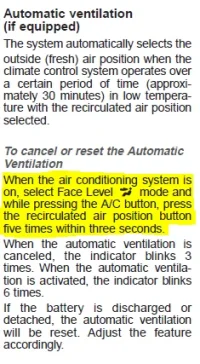

Here's the procedure for turning off Automatic Ventilation. That's the setting which will switch to recirculate after driving for a while. I believe it's enabled on new cars.
However, even with this set, my car will often be in recirculate mode when started. I've not found a way around that. With Automatic Ventilation off, at least it stays off until the next time I start the car.
I tried that yesterday, and I am just wondering if my GT1 is just not equipped with that feature since I could not get it to work.
