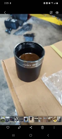

I have 3k miles on my twin cans of this type on my 3.3 Liter S. I can see no baffles (and no baffles are pictured on the K8 store) and one can has only a few drops in it and the other one is bone dry. I think I made a big mistake buying these cans which are totally empty, have no filters or baffles that I can see and don't seem to do anything. Does anyone else have these and what is your experience?
All ADD W1 Catch Cans that we sell are 100% baffled. Here is a photo of the baffle on the inside of the can:
I would double check to verify it is installed properly if you are seeing only a few drops. However, keep in mind that the PCV side will see a lot more oil than the CCV side, which tends to usually only have a little bit of buildup inside.
I responded to the email that you sent this morning, but there is nothing wrong with the product performing properly when installed correctly. The Mishimoto direct fit catch can is also a similar shaped design made in China, just like the ADD W1 is. If you were to have that one installed the same way, it would collect the exact same amount of blowby the one you have now is collecting.
Thank you. They are installed correctly and based on your email and note here, I can only assume that I'm running cool enough and the oil is not evaporating or as Kodiak says, its a seasonal thing.

You’re very welcome. Yes, that is correct. They will produce more oil inside the cans during different seasons based on the temperature. During the cooler winter months, you will see more buildup due to water condensation being mixed with the oil.
Thanks for straightening me out, Dave and Kodiak! Give me a small block V8 with a carburetor and I'm all over it. This new technology is just that, new. Thanks again to you both.
