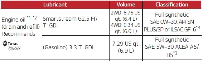

Moving another conversation to this thread. For the 3.3L, I'm trying to find clear evidence that Mobil 1 Synthetic meets the requirements. I don't care if I'm right or wrong but I think it would be good information for everyone. How to we know what API Latest (ILSAC) Latest when looking through oil data sheets? API SP?

Still not an answer though... If API SP is the latest specification then it fits and we can prove that Mobil 1 works. I don't know why it wouldn't say that in the manual. Things change from year to year, so we can't just go with what was said in the past. Here it is from the API website.

But it says exactly that. "API latest (ILSAC Latest) OR ACEA A5/B5 Full synthetic grade engine oil for 3.3 T-GDi"
One OR the other. It's at the bottom of your screenshot from the owner's manual.
