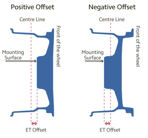

I can't begin to describe how useful this explanation is for me. I want to make sure I understand correctly. Offset is measured from the centerline of the wheel right? So a 35mm offset would mean that the mounting face is 35mm Towards the outside of the wheel from the centerline? And a 55mm Offset would be mounting 55mm towards the outside of the wheel from the centerline?
The bigger the offset, the closer to the suspension. So, for instance, that +55 would be crammed against your front strut. But a +-0 would have your outer rim exposed beyond the fender, i.e., "poke". The wheel with no offset, or negative offset, would also look very concave, which of course is a favorite look to hot modders.
