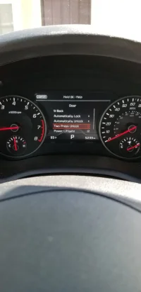

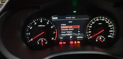

There is a setting how the unlock/locking should work. Unlock at P isnt a 100% i've noticed.
That setting has nothing to do with automatically unlocking when shifting to park, which is under the "Automatically Unlock" section right above.
All of this is in the manual.
Well mine didn't work until I disabled that feature.....beginner's luck!

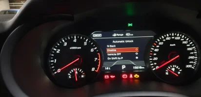

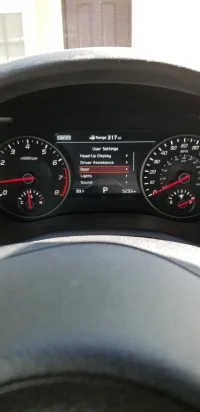

There's an option to have the doors unlock when put in Park. I just saw it a couple of days ago.
All my Kias have been less than 100%. Actually less than 50%, at unlocking. I have tried setting when shift to park, and on key out.
