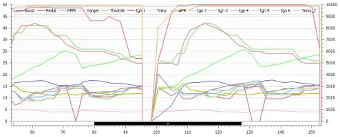

Received the new chip, installed and voila, bluetooth/logging issues have been resolved. I took the car our for a short test drive, ran great. The turbo did not cut out but it's 70 degrees here so if it's temp related, it wouldn't happen today.
I've attached my first log. If you could take a look at it and let me know if all looks good. Apparently, the JB4 firmware is stored on this chip because the version was at 16 rather than 17 that was loaded over the weekend.
Thanks for the great support!!!
Glad that sorted it! Log looks good to me.
