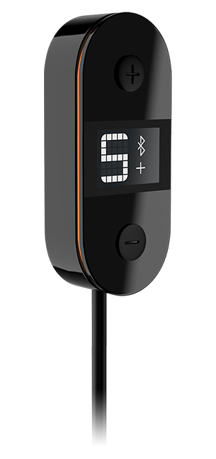

Note, there are inline plugin products like Pedal Commander and I think one by Burger Motorsports that can adjust how the throttle input is received by the car. Those boxes would be able to adjust the throttle response portion of it.

There is a BMS Pedal Tuner coming out that is $179 and works better than the above mentioned options. :) But no pedal tuner will change your shift points.
Awesome, yes price was steep. I'll wait for the BMS. Just stumbled across the above on YouTube and was inquiring
Ours should be on our website this week. :)

I can't comment on the BMS or RaceChip versions, but I bought the Pedal Commander Bluetooth for my 2.0T and have been driving with it for about a month. What other reviewers have said is true: it really does make the Stinger's Comfort mode feel like Sport. I usually drive with Stinger in Comfort and Pedal Commander in City mode +4, but sometimes I'll kick both of them into Sport for some fun (this comes in handy while passing other cars on the highway). Frankly, I can't even put it in Sport+ mode because it's just too much for city driving, but I bet it would be a blast at the track. I'm interested in seeing what it would do in combination with a good tune, but I'm taking baby steps.
All in all, while it was expensive, I do enjoy it. When I disable it, the car feels sluggish.
