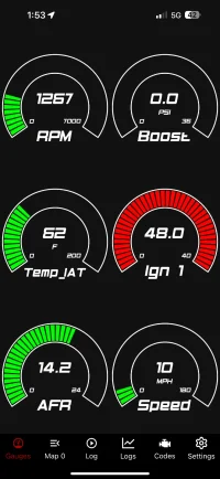

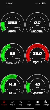

Ok ill try however when I get on it a little hard it the turbo is loud and kicks some, I don’t really know how to explain it other than that it just jerks the car but if I get on it slow slowly and smoothly it seams fine, also I’m sending a screenshot of my gauge cluster is this normal?

The gauges look fine, but they also aren't telling us much besides the fact that you're cruising along at 10 and 40mph. Ign numbers are sky high because it's a modern car and does creative things when off-throttle to maximize mileage...same deal with the high AFR. We need to see how it behaves under load.
